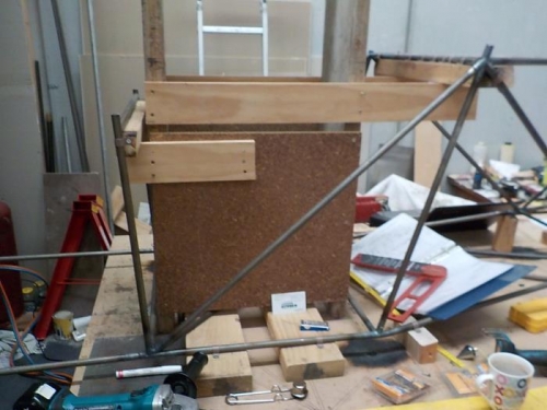

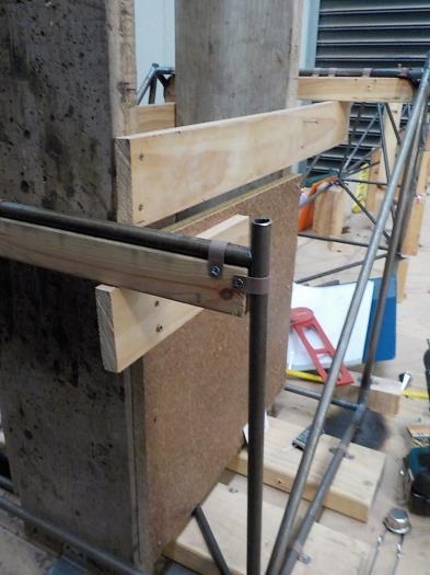

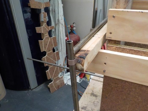

Date: 7-29-2016
Number of Hours: 2.00
Brief Description: Station 2
Station 2 jigging took time as the station itself leans forward 1-1/4" at the top and is 22" above the lower longeron. Add another 1-3/4" for the height the fuselage is sitting above the table so it actually sits 23-3/4" above the table. Fishmouth the ends of all tubes so they meet nicely, clamp and then tack weld.
Jig
Clamp
Tacked
