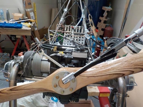

I plan to run the engine in 3 days so have torqued the AN5 prop bolts to 14ft lbs and will let it settle for a few days then will torque to the final 15ft lbs before starting.

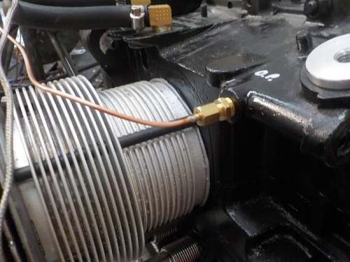

The oil pressure line is now in and connected. No use of tape is recommended or required. The threads are NPT which are tapered and hold a good seal when tightened.

Torqued
Torqued
Oil pressure
Oil pressure
