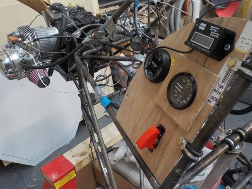

The prop is bolted on (yet to be torqued) and essential engine monitors are being connected prior to first run.
Tiny Tach tachometer

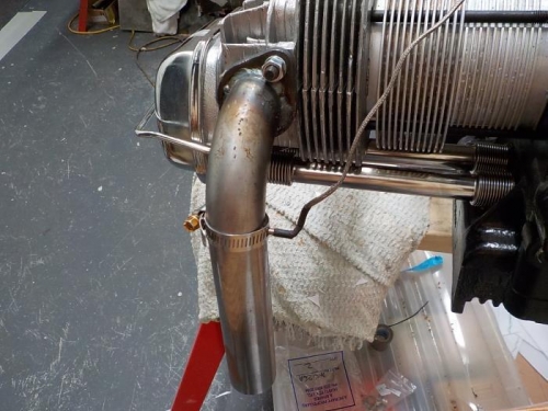

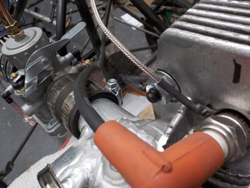

EGT & CHT probes and gauge
Oil pressure and temp gauge as well as the P-Lead.

The test panel is mounted on the side of the fuselage so I can read it easily when standing beside and operating the throttle just below.
Test panel
Test panel
EGT probe
EGT probe
CHT probe
CHT probe
