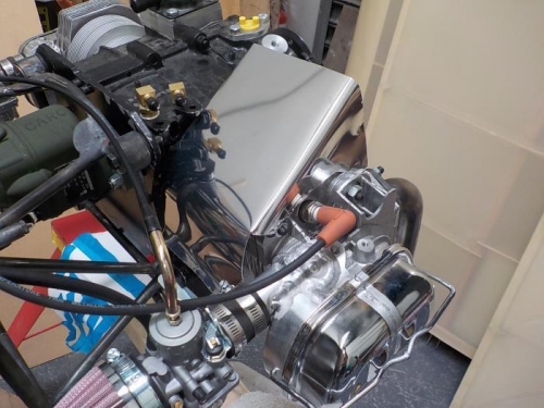

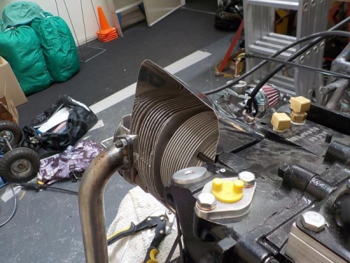

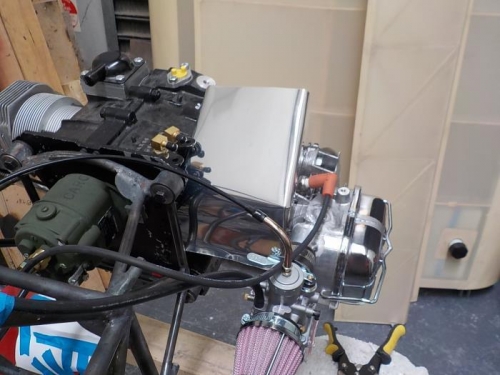

Brief Description:  Design 2 made up
Though this cooling tin is made up from .025" 6061T6, it will not be the final iteration as I feel it is a little too high at the front and I also want the gap at the carburettor corner to be filled with an extended piece of folded aluminium and not just an added extra riveted in place.
Not quite tidy enough...but close.
29/1/17
After discussing the cooling tin options with Scott Casler I have decided at this stage to not use them as there have not been any indicators that the 1/2 VW has cooling issues as the cylinders just hang out there in the breeze and are not confined within a cowling.
