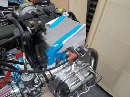

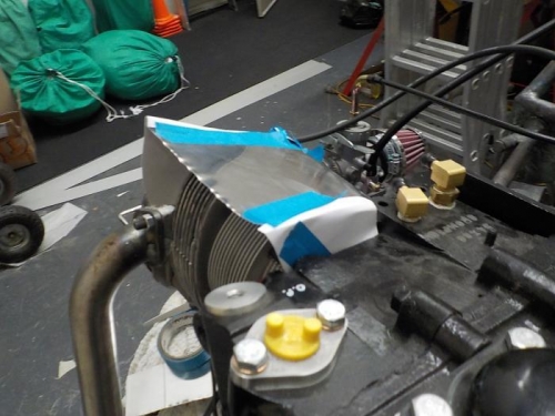

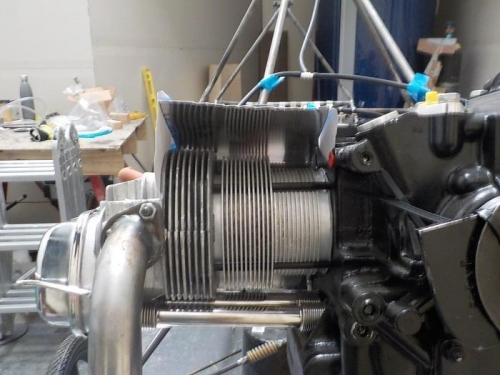

Brief Description:  Cooling tin design 2
This is the second design for the cooling tin.
This one curves from the front to the back with a couple of verticals relieved to clear a few bits and pieces.
I am leaning more towards this design as I like the way it smoothly directs the incoming air around the rear of the cylinders rather that having to pass through a 90 degree angle at the back. It also keeps the incoming air closer to the cooling fins.
