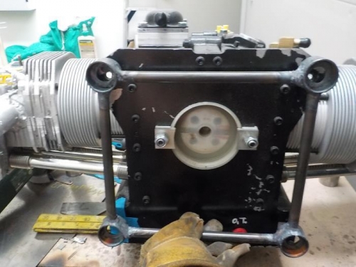

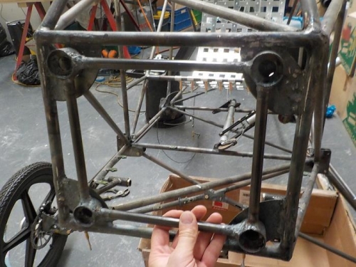

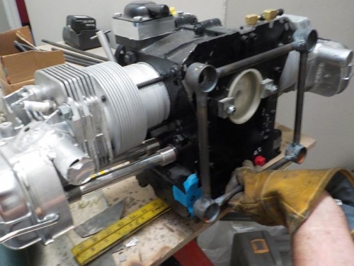

Brief Description:  Ring
I have decided to go with the ring mount mainly because the holes in the rear of the engine case line up closely with the firewall points. This means the actual mount tubes would travel almost straight from case to firewall as can be imagined from pic 1. It would be impossible to weld to the pre-made mount tubes which bolt to the engine and firewall.
Tubes are 1/2" x .049"
Closely aligned
Closely aligned
Left rear
Left rear
