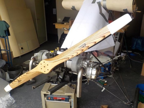

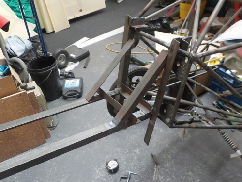

Bought steel from the local hardware and knocked up a very agricultural bed mount to sit the engine on and slide fore and aft to establish the correct CG. The mount just hooks over the top of the firewall.
Welded hardware steel
Hooked over
Hooked over
Engine rested in place
