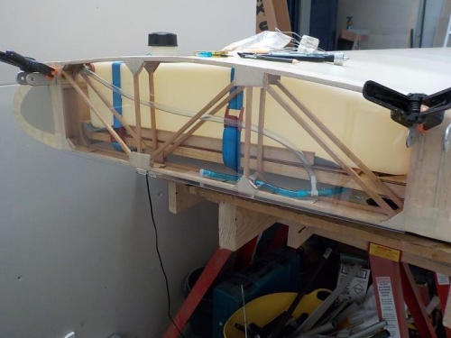

Started to run the fuel lines.
The fuel tank outlet is at the bottom left hand side in the 1st pic. (Left hand wing) The Bing alcohol resistant fuel line enters a tee and continues ahead to the fuel tap which runs to an elbow that exits through the bottom of the wing. The clear line running to the front top of the tank is the site gauge and will have black card behind it showing 1/4, 1/2, 3/4 and full.
The fuel tap is an AS&S "In line fuel valve" Part # 15-05420.
Fuel lines are all safety wired and secured to prevent movement.

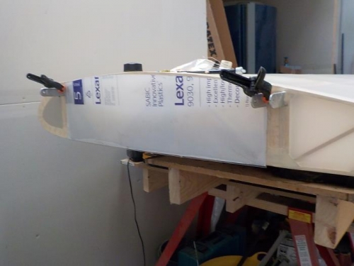

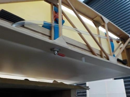

The fuel tanks came with 1mm Lexan sheets which were to be used as covers on the upper part of the wing, however I chose to continue the Oratex. I have cut the Lexan and used as covers on the inside of the wing root so I will be able to look up and see the fuel level. The 3rd pic is of the right hand wing and the Lexan though hard to see is just held with clamps at the moment. Glad I have been neat and tidy with the glue joins and everything else in there.
