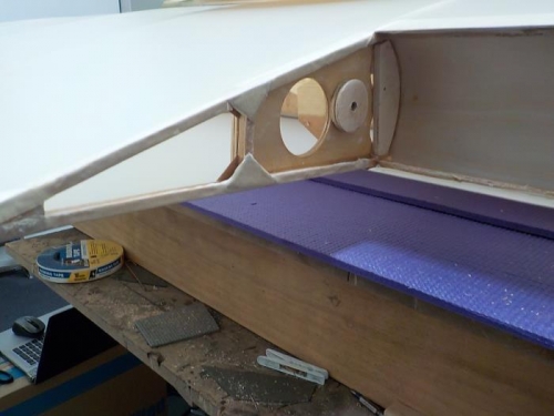

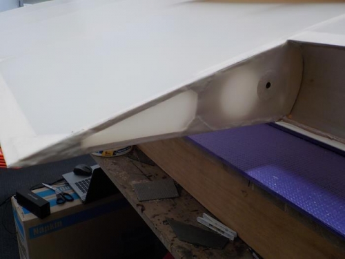

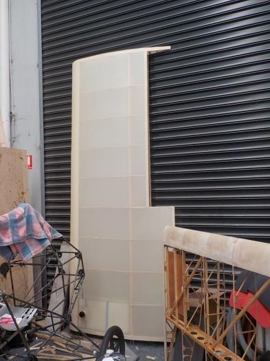

In order to keep the fabric taut on the insides of the aileron/wing intersection, I had to glue 1/4" plywood pads to the curved corners as well as where the hinge bolt comes through. Took some time to get it all right on both wings but worth the effort when finishing off with the Oratex. The right wing is finished now as work begins on the left one....The ill fitting aileron gap seals have been cut out and the new ones glued into place.
