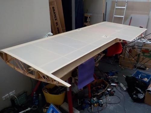

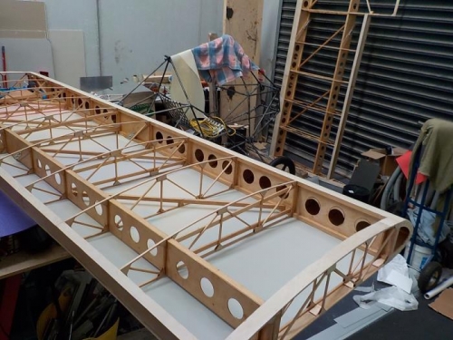

Brief Description:  Lower surface finished
What I thought was going to take maybe 2 hours took a lot longer however the result is well worth it with not a single crease or bubble anywhere.
The leading edge is adhered first and then the fabric pulled tight to the trailing edge, then the ribs and patches. Heat shrink the entire surface and finish off the outer edges to tidy them up.
There is method in using the Oratex and I am enjoying the process.
Right side up

Up side down
Up side down
