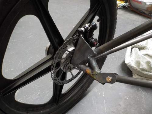

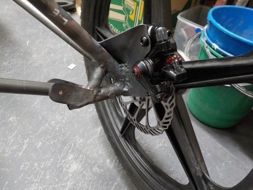

Brief Description:  LH disk brake
At first thought I imagined it would be easy enough to replicate the already made calliper mount for the left hand side. Wrong! The callipers are nether left or right but both identical. They need to be also facing so the activating arm is at the bottom ie. brake cable comes in from the top.
The mounting plates are very different for both and as can be seen in the photos which have been taken from the front of the fuselage. The LH brake sits forward of the mount and the RH one sits to the rear.
Hours spent fiddling, tacking and adjusting before eventually welding see both in their correct positions....finally.
Left hand

Right hand
