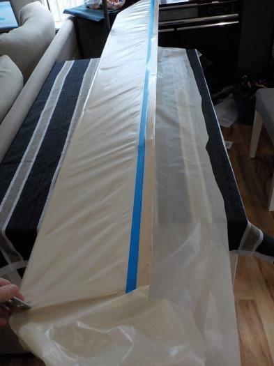

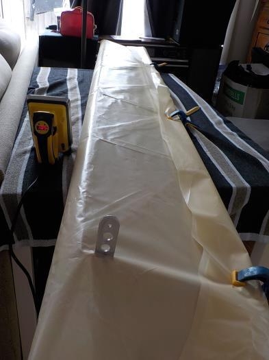

Spent 5 hours over the weekend covering tailplane surfaces.
There is a process to be followed when doing the aileron.

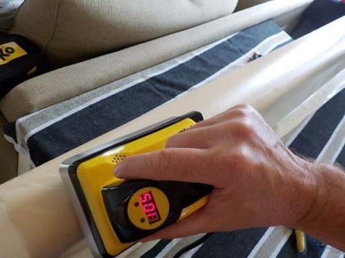

After the fabric has been ironed to the leading edge, it is then ironed to the one side only of the trailing edge and then a blue line of masking tape marks where the other side of the fabric will be glued to. Hotmelt glue is then painted on the fabric up to the blue tape line as glue must be applied to both surfaces to be adhered together.
Loose
Loose
Iron
Iron
