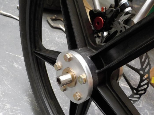

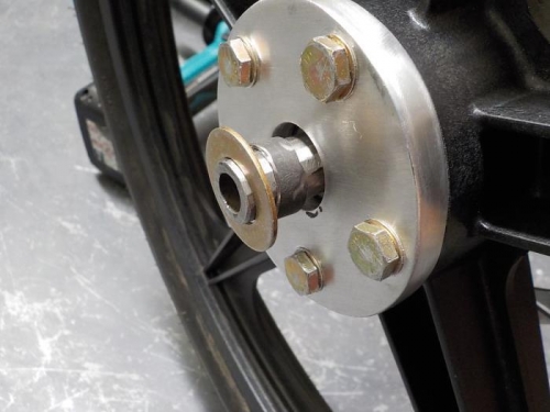

The outer spacer is cut from 3/4" x .035" tube and sits up against the inner race of the wheel bearing. There is clearance between the crush plate and the spacer as well as the washer as they do not turn with the wheel. Cotter pin will hold the washer firmly against the spacer.
Spacer
Spacer
Washer
Washer
