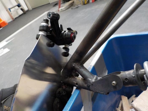

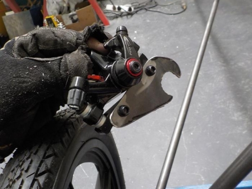

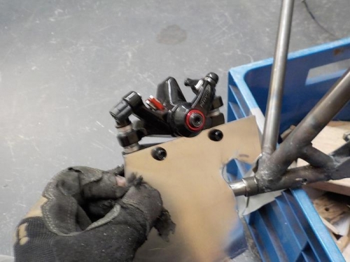

A mount welded to the gear leg will hold the brake calliper so first tried to make one from .063" 4130N only to discover it needed to be precisely made else the disk rotor scraped the calliper. So I have made a template from hardware aluminium which is easily bent to fit the geometry of the landing gear leg. From this template a more precise steel mount will be built and welded.
