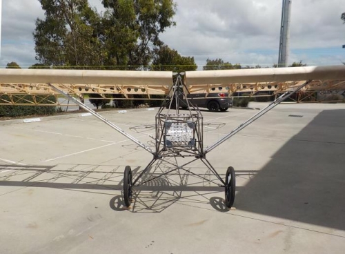

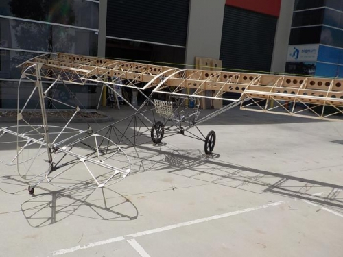

It was time to take the Legal Eagle out of the factory space and mount both wings for the very first time. Previously I have only been able to mount one wing at a time in the restricted building space so now was the time of reckoning. Thankfully they both bolted on easily enough and the struts too.

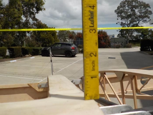

In the pics you can make out the string line pulled taut between the wingtips. 3" dihedral when measured at the root was spot on for both wings.
Very happy with the changes I made to the tail shape.
It really is coming to life now.
In the car park
In the car park
Rear 1/4 view
Rear 1/4 view
3" dihedral
