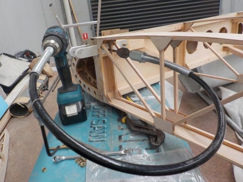

To clean out the holes through the wing fittings and spars I attached the flexible drill shaft to get in awkward spots that the drill can't fit.

Flexible drill shaft
