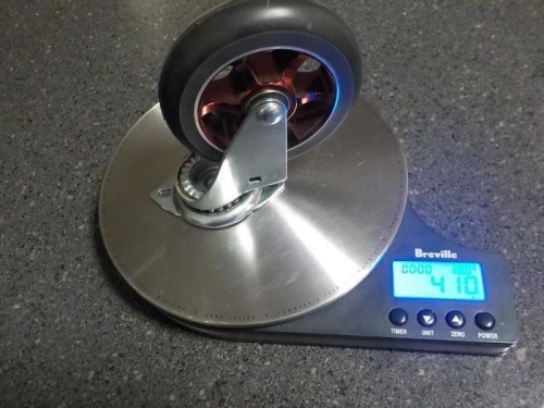

Total weight

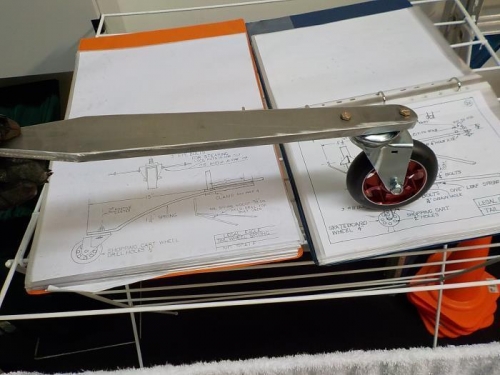

Yet to be bent to the final shape but as can be seen, the total weight will come in at around 2 lb and a cost of under $35 when the steering arms are attached.
410 grams / 0.9 lb
880 grams / 1.9 lb
