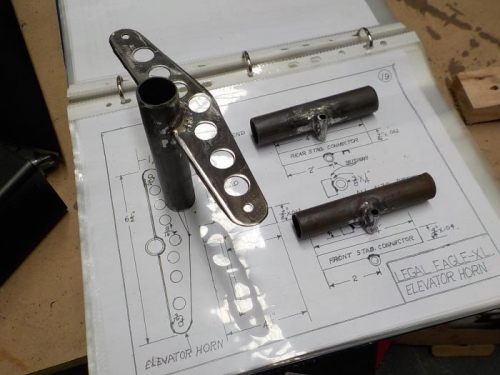

Brief Description:  Elevator horn
Elevator horn as cut from .035" 4130N. Holes were marked and cut and then the flat steel was clamped in the vise and the 1/4" trailing edge heated and bent over using a hammer.
Notched the semicircle for the 7/8" x .062 tube. Magnets holding it square to get the tack weld done.
Stabilizer connectors and the elevator horn are now finshed.
Ready to tack
Ready to tack
