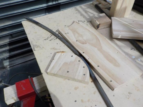

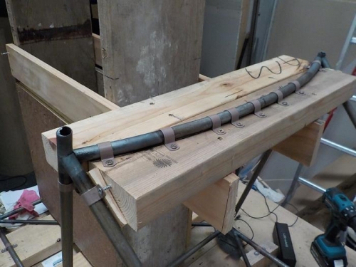

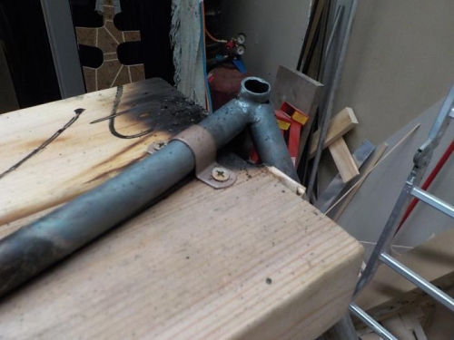

Left over timber jigs are screwed to the workbench. The 5/8" seatback tube is heated with the acetylene torch and gradually bent the 2" to match the predrawn shape. The ends are fishmouthed to intersect and make a neat 3 way cluster and then tack welded.
Bending jig
Bending jig
Clamped
Clamped
Tack welded
Tack welded
