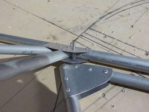

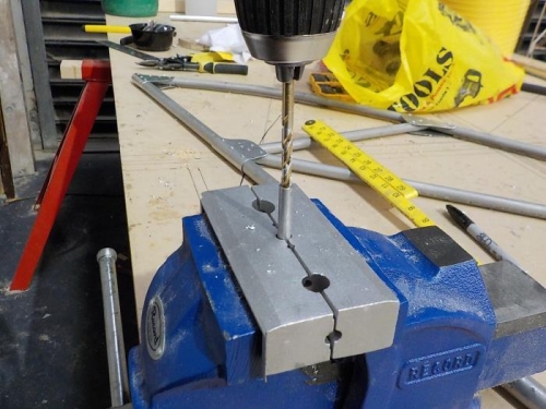

Holes drilled for the horizontal stabilizer cable attach points and 1/4" aluminium tube reamed out to 3/16" with the drill. The tubing was cut to fit between the attach points on the gussets, JB Weld applied to secure them. Whilst drying I had threaded rod inserted to keep everything aligned until dried.
Drill to 3/6
Drill to 3/6"
JB Weld
JB Weld
