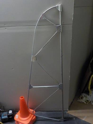

Brief Description:  Rudder

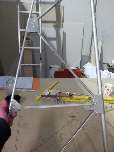

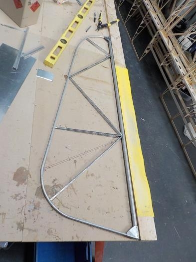

Due to the change in rudder shape at the top, ie. rounded and more shallow, I added an extra rib to reduce the chance of deforming the trailing edge when shrinking the fabric (Oratex). To make up for the slight loss of rudder area the rudder is 1/2" wider to the trailing edge.
Drilled and riveted, it is incredibly light and strong.
