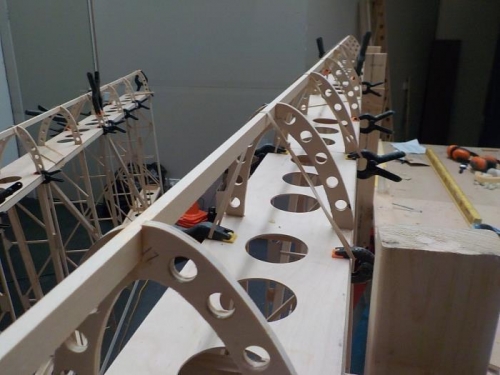

Brief Description:  Nose ribs

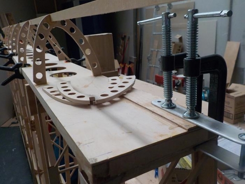

After pre-fitting the nose ribs to be absolutely sure of their placements, epoxy was added to both mating surfaces and pressure applied with elastic bands strung over the 5/16" x 5/8" leading edge timber.
To fit the end ribs I needed to epoxy the wing fittings into place. Bolts were used to align the fittings and g-clamps used to apply a light pressure so as to not squeeze out all the resin but enough to form a good bond. Chose to not use the black spring clamps as the pressure they apply is continuous whereas the g-clamps apply only as much as you screw them down and then no more. Removed the positioning bolts as they are cheap 1/4" and just used for aligning purposes and I don't want them epoxied in and unable to extract.

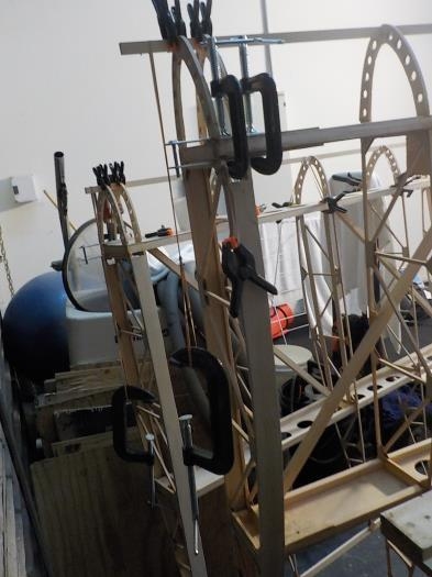

End ribs cut to fit over the wing fittings and a large g-clamp hanging off elastic bands applies enough vertical pressure to hold them in place and not have the ribs move.
Elastic bands
Elastic bands
Wing fittings
Wing fittings
End ribs
End ribs
