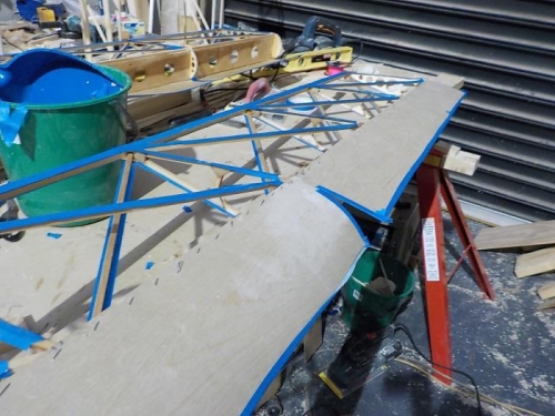

Brief Description:  Varnish ailerons

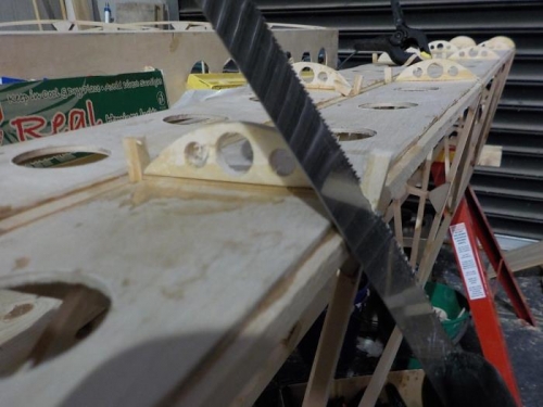

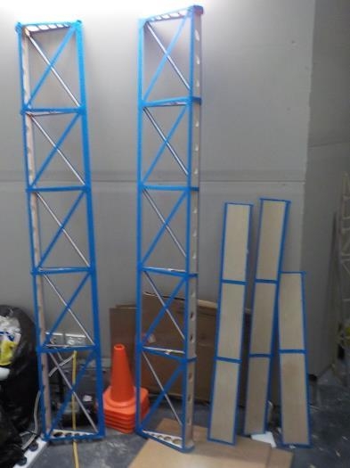

Trimmed off the overhangings and then taped all timber surfaces that do not need varnish. ie. Any surface that is going to have further glue applied. That being the 0.8mm leading edge plywood and the fabric covering. Used "Feast Watson Spar Marine Varnish" available at Bunnings Aerospace..
Glued just the top edge of the plywood and have held in place with many staples. Will second coat the varnish tomorrow at which stage the leading edge will be finished off in the afternoon.
