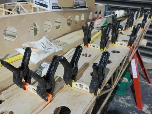

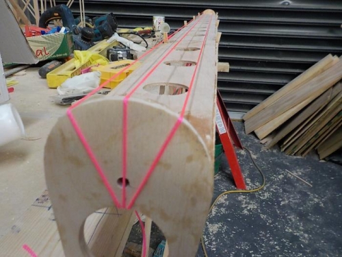

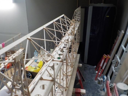

There was something mildly satisfying when cutting the aileron free from the wing and seeing it pivot as an aileron should. Straight away I pulled the temporary hinge bolts and set the string lines between the end ribs and proceeded to cut, lighten and sand each nose rib to fit perfectly. Epoxied now just holding in place over night with the clamps.
Movement
Movement
String lines
String lines
Holding
Holding
