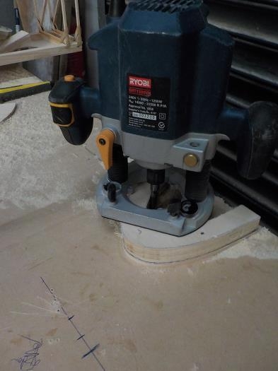

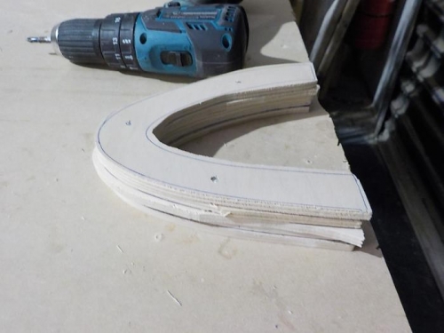

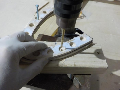

Pre drilled each nose rib with 2 pilot holes. 3/16" dia.
Screwed up from under the bench through the first 2 which are already shaped and into the 3 above. The router bearing sits on the bottom 2 and routes the top 3 to shape.
Pre drill
Screwed from below
Router
