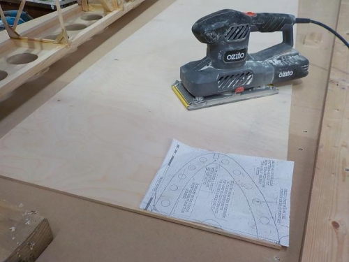

I measured my print out of the nose rib to be absolutely sure it was going to be the correct size for the main spar. Spot on. It was glued to the 1/4" plywood which I decided to sand before cutting out the ribs to save fiddly sanding down the track.

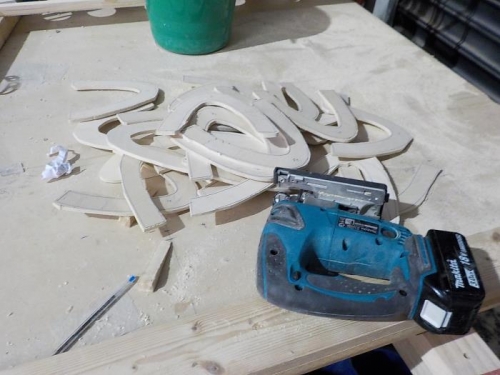

Rough cut the ribs out of the 1/4" plywood with jig saw.

Rough cut
Rough cut
