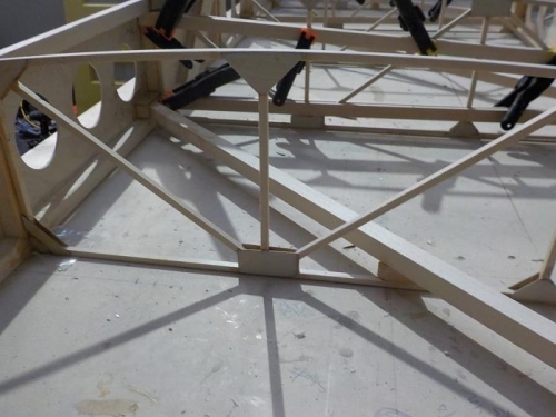

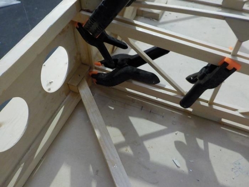

Brief Description:  Finish diagonals and compression ribs
All diagonals and the remaining upper compression ribs are epoxied.
Spacers were sanded down to fit between the diagonals and the rib crossing points.
I have not lowered the diagonal where the fuel tank sits as I plan on building mine to go from the front to the rear spar in the first bay and will have increased capacity as a result.
