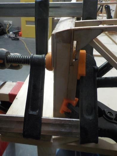

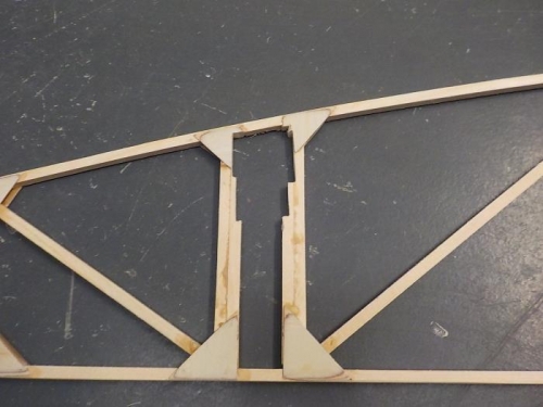

Brief Description:  Altered cutouts
The two ribs at the wing root need to be relieved of timber to fit around the 1/8" plywood strengtheners and the aluminium fittings. These ribs were built with double thickness verticals earlier. Measured, marked, sawn and chiselled out for the main and rear spar, the ribs are now epoxied and clamped whilst I wait for them to cure over night.
