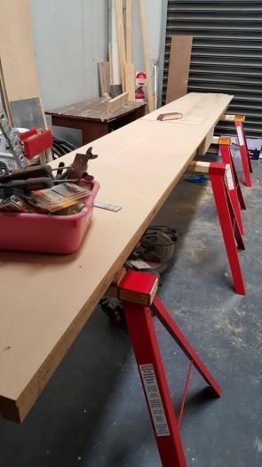

Brief Description: Bench

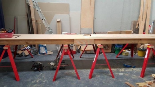

Workbench is 16 feet long and 2 feet wide.
Constructed from 16mm MDF screwed to 140mm x 45mm beams and supported on saw horses. All levelled and perfectly stable for spar building.

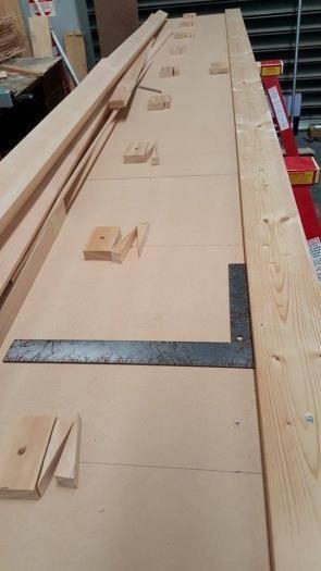

Straight edge of timber to build the spars up against is screwed down.
The upright pieces on the spar are drawn onto the bench surface at the 15" intervals and then blocks screwed above each where the wedges will hold things firmly in place.
