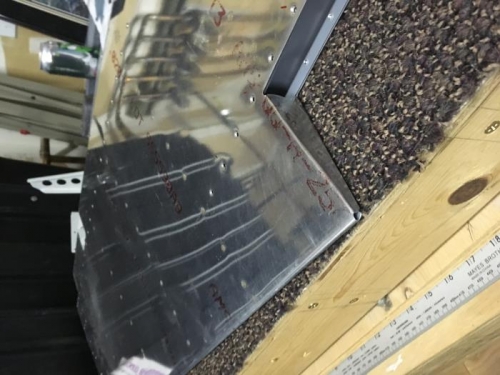

Brief Description:  Bend elevator tabs
Bent the elevator tabs where the elevator butts up against the trim tab. The trim tab will require two similar bends. I fabricated a wedge and clamped the wedge blocks to a hard surface. I put an initial bend on it with a block and then finished it with the riviet gun with a flush head attachement.
Bent the two tabs there
