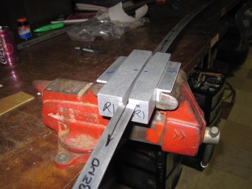

Saw a set of dies made just for bending RV longerons somewhere a while back, and ordered a set for about $40 as I recall. I wasn't crazy about doing the hammer thing; these looked like a more precise way to get the job done. I made up a pair of aluminum angle pads to replace the cast iron faces of the vise jaws, and bent the first long curve in the right side longeron. It came out pretty well.
Vise jaw pad made from non-a/c aluminum angle, with shims behind.
