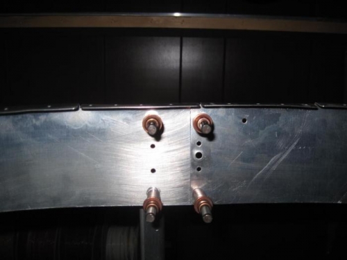

Continued on the F-706 bulkhead by match drilling all the holes, then disassembling all the parts, doing the debur thing on all the holes, and checking that all the edges of the parts were smooth and ready for cleaning and priming.
The F-706 bulkhead clecoed together and match drilled.
I first tried to cleco the vertical bellcrank channel to the center holes, didn't want to fit.

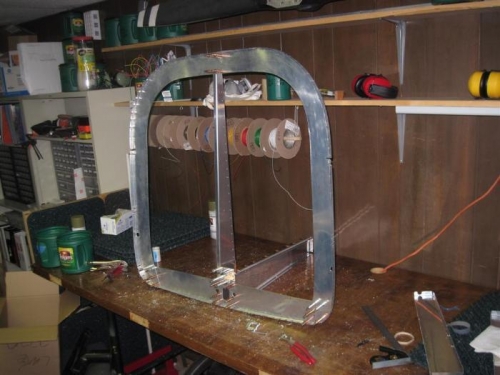

All the F-706 pieces ready to clean and prime, then rivet together.
