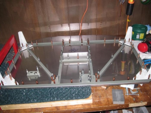

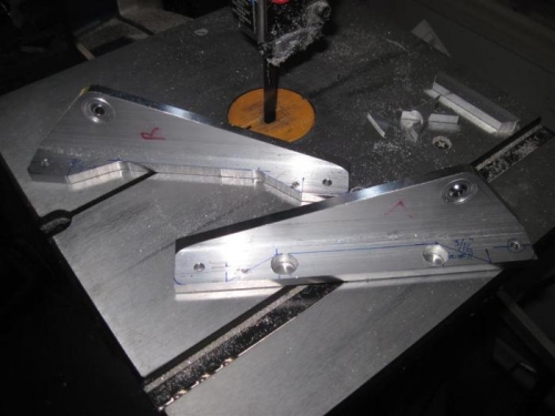

After countersinking and priming the aluminum parts, and dimpling the stainless steel firewall, I got it all clecoed back together and riveted in place. Then started on the center section, part of which consisted of mounting the control stick support brackets, then lightening them by cutting out part of the flange that is against the bulkhead.
Firewall reassembled, ready for riveting.

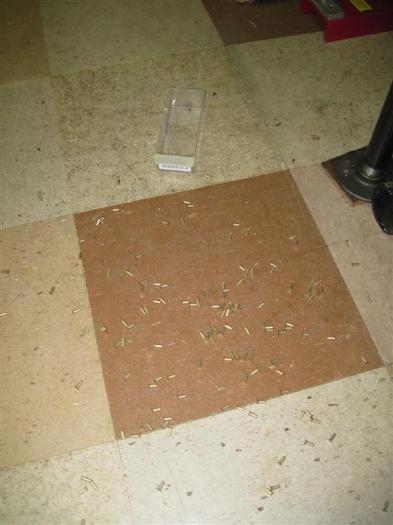

What happens when you get the little drawer with rivets too close to the bucking bar.
The control stick mounting brackets being lightened.  Drilled some 1/2
The control stick mounting brackets being lightened. Drilled some 1/2" holes to make a nice radius.
