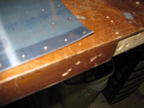

Finished straightening the bent corner on the outboard bottom wing skin, looks OK, but I'm glad it's on the bottom. After rolling the edges a little, it doesn't look too bad.
Pressing helped some, but it needs more.

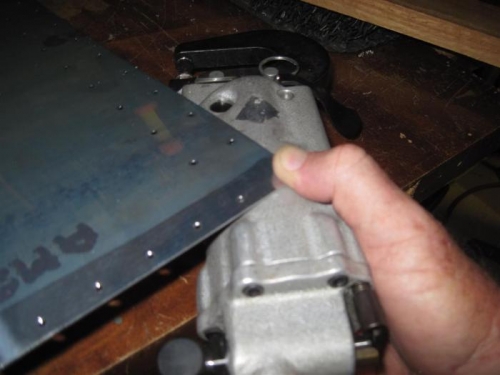

The outer radius of the rivet squeezer looked about right, so I bent it a little more.

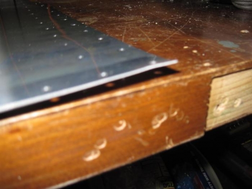

That is about as good as I think I can get it without messing it up more.  I will roll it and go.
