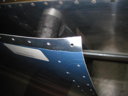

Then when removing the outboard bottom skin from the wing for deburring and dimpling, the last cleco pulled out prematurely and dropped one corner of the skin on the floor, and bent it over, at which point I dreamed up a few new expletives, or at least some new combinations thereof. Hope I will be able to straighten it satisfactorily without it stretching too much, thankfully for appearances sake it is on the bottom of the wing.

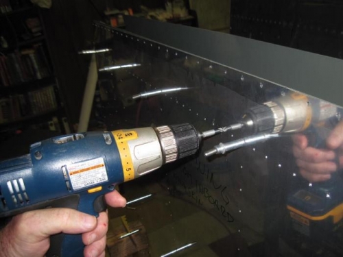

Got the bright idea of clecoing the skin to the wing skeleton for deburring the holes, easier to get the drill on them that way. Works well.
Well, that sucketh!
Well, that sucketh!
Using wing frame for supporting skin for deburring

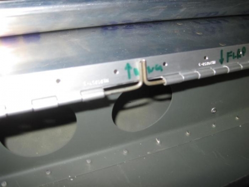

Finally got the right cutout in the hinge.
