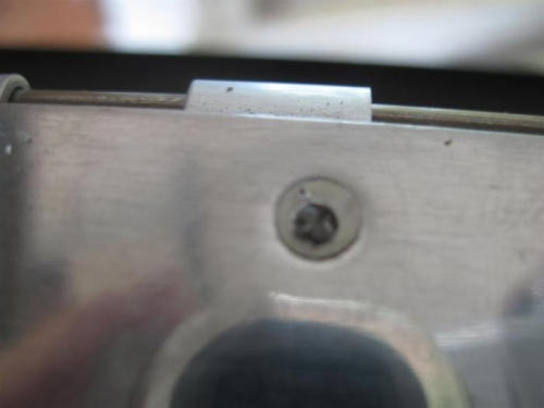

Drilling the hinge flap rivets on the drill press.  Worked pretty good until...

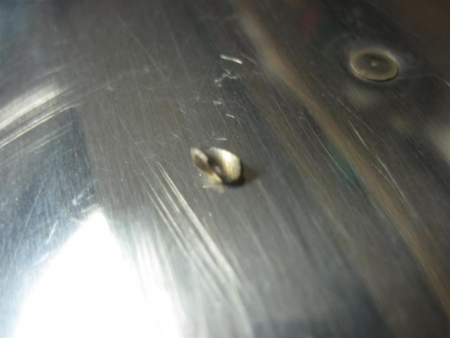

Oops!  Drill bit broke off in rivet being drilled out.  What now?
Tip of drill bit.  No more cheap drill bits, even if drilling only aluminum (mostly).
