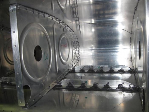

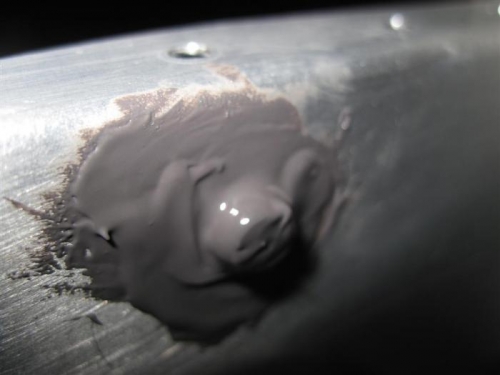

This morning after getting back from the pancake breakfast at the EAA 690 hangar at LZU, I mixed up a little Proseal and installed the 4 stiffeners that I didn't have enough sealant to finish on Thursday. Then it was off to Sandy Springs with Steve Ashby to see another RV7A project belonging to a builder named Jeremy Hull, a local landscape architect. He has his fuse nearly finished, with a lot of wiring, panel, and plumbing work done. After picking up the wife and visiting our Daughter in law in the hospital and eating a bite, I tackled the tank again, mixing up a batch of Proseal and installing the 5 interior ribs with sealant between the flanges and tank skin. To maintain the tank in as good alignment as possible, I also clecoed the end ribs in place, but without sealant. I clecoed the interior ribs in every other hole, and will wait until tomorrow to start riveting. I will also add a lot of Proseal to the interior ribs, at the edges and over the rivet ends.
The AN 470 AD6 rivet that closes the tooling hole in the outboard tank rib.
Interior tank ribs clecoed in place with sealant.
End ribs are clecoed in place without sealant, to maintain alignment.
