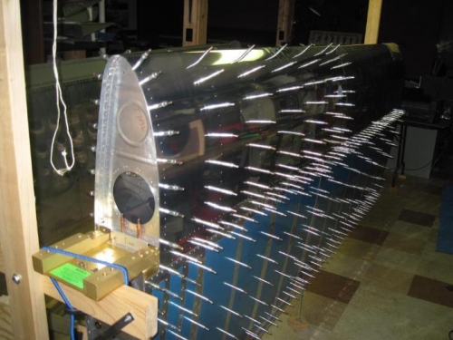

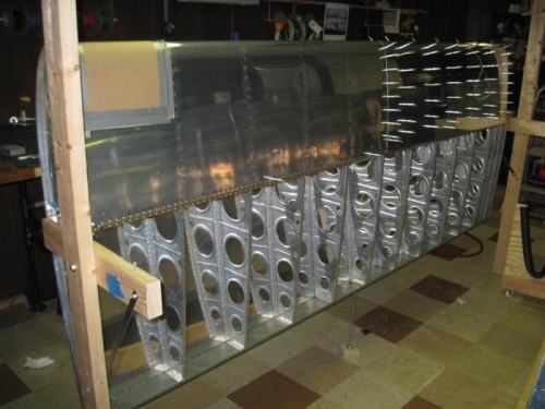

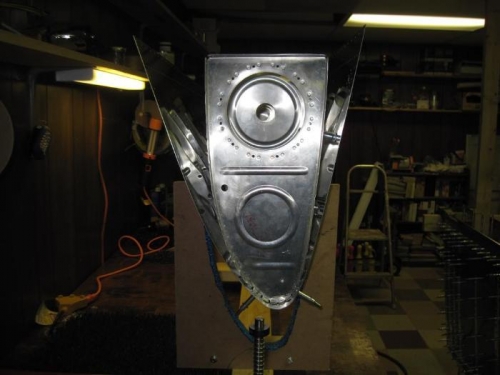

Brief Description:  Getting right tank ready to assemble (again)
I have been hitting the project a few licks when a little time has been available the last couple of weeks. I clecoed the ribs and new skin together, along with the baffle, and checked the fit on the wing, and it was just right. So, I continued by drilling out all the rivet holes and the #8 screw holes that attach to the spar and the splice plate where the tank meets the outer half of the wing leading edge. A friend from Church, who is a pilot working in Nigeria for several weeks, then home for a few weeks, came over with his son to check out the project. While they were here, we machine countersunk a few of the skin to baffle holes, very carefully and constantly checking the locknut on the microstop countersink. Don't want to buy a fourth skin!
Starting to cleco the tank ribs to the skin, using the jig as an aid.
The leading edge and the tank parts in place
Another view of the tank and leading edge.
