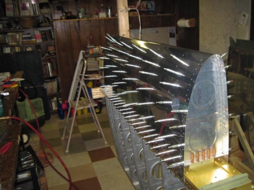

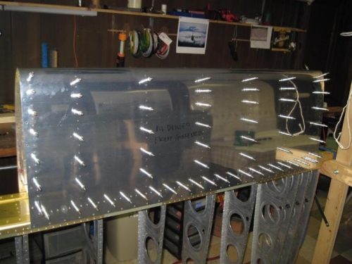

Today I finished drilling out all the holes having to do with the tank. Since I had not placed the bottom skin stiffeners in the tank when assembling it initially, I fitted them in place to the skin, after cutting them out of the furnished angle.
Now, there is a lot of deburring and dimpling to be done before anything gets joined.
The skin re-attached for final drilling.
The other side of the tank.
