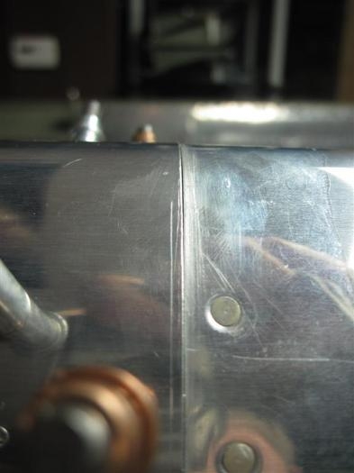

Pretty good alignment between the tank and outboard leading edge.

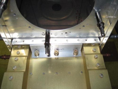

New attach angle in place, washers are to keep the screw from going all the way through the nutplate.

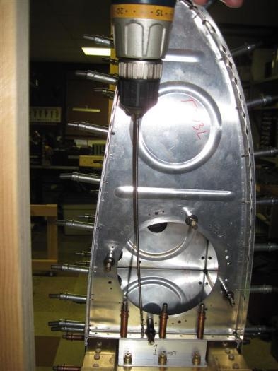

Drilling the inboard rib to the baffle and attach angle.
