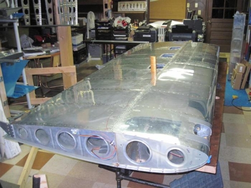

Brief Description:  Finished riveting left wing skins
The very last wing skin rivet fell immediately above the heated pitot control box. and the box was too close to the skin to get a bucking bar in between. So, had to remove it in order to drive the last one. Glad I mounted it on nut plates instead of riveting it in place. It will have to wait until tomorrow to get screwed back in place, too tired tonight.
So the left wing is finished, except for fiberglass tips, nav lights, and pitot tube. All the tubing and wiring is already in, so just installed the pitot mast, will leave the tube out until later in the process.
Looks Good!!

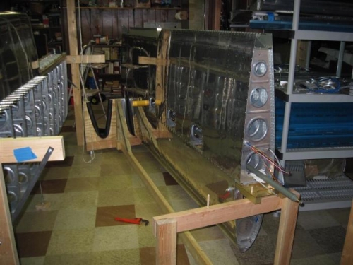

Later in the day, got NGFIIDWHAI (Never Gonna Fly In It, Don't Wanna Hear About It), aka Joyce, to help me get the wing off the table and into the cradle.
The control box for the heated pitot, had to remove it to drive the last rivet.
Finished wing, will put it in the cradle when I get the pitot control box back in place. Beautiful!
Left wing in the cradle with help from NGFIIDWHAI (Never gonna fly in it, don't wanna hear about it).
