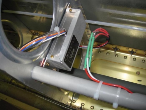

I did not like the landing litght wiring just floating in space between the leading edge and the spar and conduit behind, so got a rivnut in place on the mount and anchored an adel clamp to it to help support the wiring. I also mounted the Dynon AOA/pitot heat controller in place to a rib, and soldered the leads from the controller to additional #14 wire leads going to the wing root.

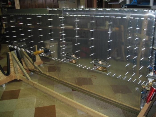

Clecoed the bottom skins in place, ready to rivet.

Pitot heat/AOA controller bolted and wired in place, and soldered leads to the wing root
Bottom skins clecoed on, ready to start riveting
