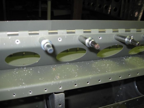

Been too long since I got anything done, have been traveling a lot and am covered up with work when I get back here. Could not stand it any longer, put the work aside this evening, and went to the next step on the ship, which was to machine countersink the holes in the bottom of the flap brace. These will receive the dimples in the skin, and the hinge will be flat on the top with no dimple or countersink. It had been so long that there were some small cobwebs between the flap brace and the rear spar.
Hard to see, but there are small specks of aluminum on cobwebs between the brace and spar.

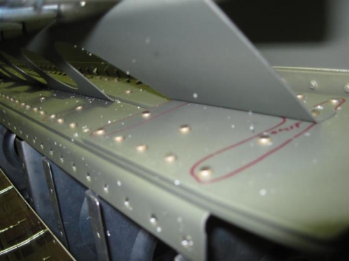

Countersunk holes between the clecoes.

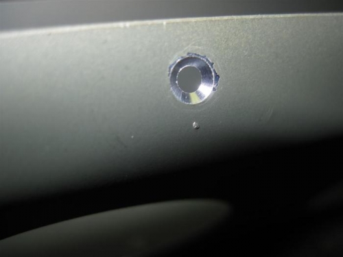

Machine countersunk hole in the flap brace.
