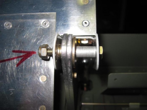

Tonight I mounted the left aileron to the trailing edge of the wing. As can be seen, the ailerons pivot on bearings in the mounting brackets, and are located laterally with washers and spacers.
Holding the last washer in place to get the bolt through is tough.

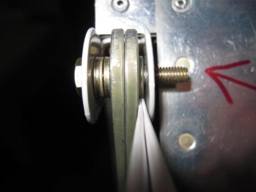

Spacer made from aluminum tube that locates the aileron laterally.

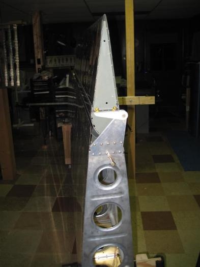

The left aileron located in the neutral position.
