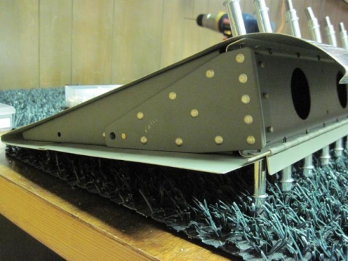

The reinforcing plate at the inboard end of the left flap.

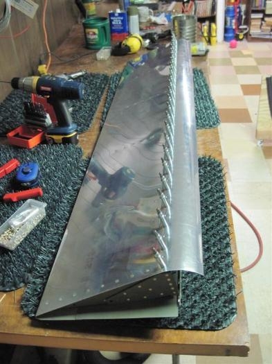

Left flap complete except the spanwise spar rivets at the top & bottom.

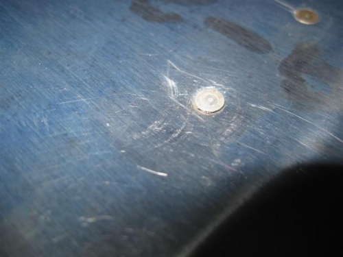

A big fat ding, on the top of the flap, too, where it can be seen.
