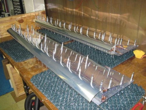

Today I took a nap after church, due to working on the flaps so late last night. After that, I got back into the project, installing the top skin on the left flap, then completely match drilling both flap assemblies. Then I disassembled the left flap only, in order to keep from mixing up the parts, and began the tedious process of deburring and dimpling all the holes. Turned out I had drilled the interior ribs on both flaps to no. 40, and they are supposed to be #30, so I drilled the left ones out to the proper size; hope I remember to do the right one when the time comes. The plans are bad about giving the drill size in the instructions, when it says drill a hole, you have to then look at the plans to see the rivet size, and drill the hole accordingly. It would be easier if it stated the drill size in the instructions.

Both flaps assembled and drilled, ready to disassemble, debur, dimple, etc.

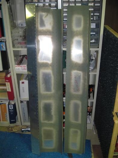

Flap skins primed.  Where Alclad is used, I am only priming the edges and rivet rows, on the inside.
