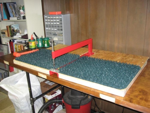

I built a support surface around the C-frame dimpler from some 3/8” plywood I found in the garage and a couple of 2 x 2’s from Home Depot Aircraft Supply House. It turned out pretty well; it’s lightweight and has some plastic grass mats to support the sheets. This made it easier to finish dimpling the HS skins, except for a few near the leading edge, which will have be done with the hand squeezer if it ever gets here. I also can’t dimple the rib flanges until the squeezer gets here.
The sheet support for the C-frame dimpler with grass mats to prevent scratching.

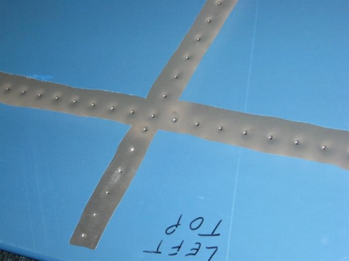

Some dimpled holes of the 460 in the HS skin that will be dimpled
