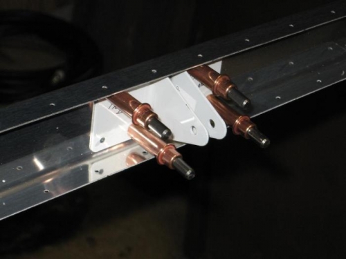

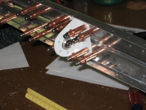

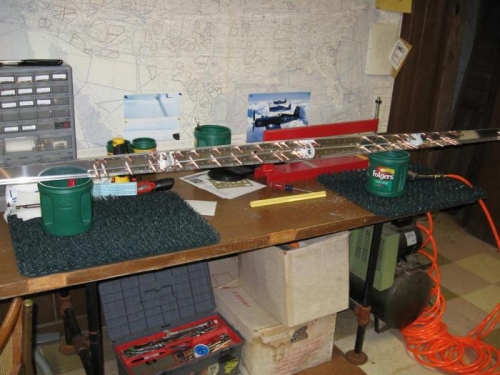

Got some progress made tonight. After looking all over the basement and garage for the air hose I bought a few weeks ago at Sears last night and part of tonight, I remembered I had left it out back under the tarp that is over my radial saw that I use for the Gazebo construction. Got it hooked up and found an air leak in the compressor piping, so had to take the instrument panel off the compressor to get to the joint to fix it, then got the new hose and miniature fittings from Avery Tool hooked up and working. Finally got to work and used the new air drill Steve Ashby brought me for the first time when I clecoed the rear HS spar and reinforcing strips together, drilled out all the holes to # 30, attached the elevator hinge brackets and the center hinge bearing. Wound up with the rear HS spar completely assembled, now all I have to do is take it all apart again for deburring and dimpling, priming, etc.
Rear HS spar all clecoed together and supporting itself across two coffee cans. You can see that the C
Elevator hinge bracket.
Center elevator hinge bearing.
