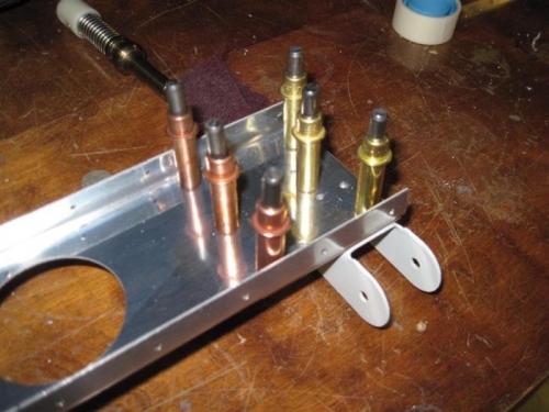

Stiffeners ready to back rivet on the plate peeking out from under the skin

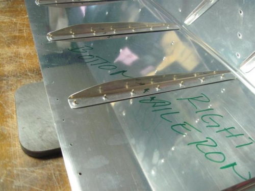

Stiffeners all riveted in place

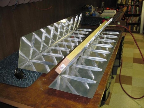

One end of the aileron spar.
