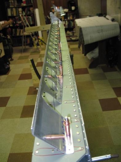

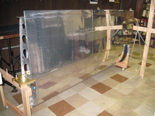

After working most of the day, I took some time to finish the wing stand by cutting out the rib profiles in the end support, and lining it with pipe insulation. After getting Joyce to help me get the left wing off the bench and into the stand, I got out the flap brace and the aileron gap fairing, deburred and smoothed the edges, clecoed them in place, and match drilled the holes to the spar, and in the case of the fairing, to the top skin.
Left wing in the wing stand
Flap brace clecoed in place
Aileron gap fairing clecoed in place
